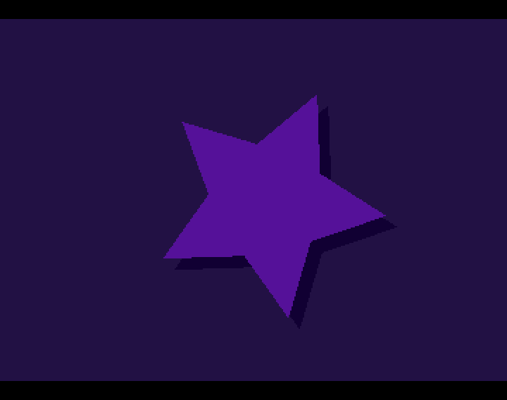

        Voila un nouveau petit code source extrait de la démo : https://www.pouet.net/prod.php?which=87666
        Il s’agit de l’étoile violette. Simple : petite rotation petite ombre.
        Le code à copier dans Amos Community:
        ‘ Simple rotating flat star
        ‘ From the demo « Happy New Year 2021 » / Agima dec 2020
        ‘ A bit reworked to be standalone
        ‘ in 50fps on vanilla A500 of course
        ‘ Aghnar ; may 21
        Set Buffer 32
        Dim C(1024),S(1024)
        Global NDP,C(),S()
        Global CX,CY,ANG
        Global T
        Global X1,Y1,X2,Y2,X3,Y3,X4,Y4,X5,Y5
        Global X6,Y6,X7,Y7,X8,Y8,X9,Y9,X0,Y0
        Global XE1,YE1,XE2,YE2,XE3,YE3,XE4,YE4,XE5,YE5
        Global XE6,YE6,XE7,YE7,XE8,YE8,XE9,YE9,XE0,YE0
        Degree
        For I=0 To 1023
        ANG=I : Rem ((1024*I)/360) avec i (0,359)
        C(I)=Qcos(ANG,256) : S(I)=Qsin(ANG,256)
        Next I
        Screen Open 0,320,256,4,Lowres
        Flash Off : Curs Off : Hide On
        Palette $214,$519,$103,$519
        Paper 0 : Cls 0 : Pen 1 : Ink 1
        Double Buffer : Autoback 0
        ANG=0
        CX=160 : CY=128
        ‘ Definition of the star
        NDP=10
        X0=170 : Y0=0
        X1=69 : Y1=49
        X2=52 : Y2=162
        X3=-26 : Y3=81
        X4=-138 : Y4=99
        X5=-85 : Y5=0
        X6=-137 : Y6=-100
        X7=-26 : Y7=-81
        X8=53 : Y8=-162
        X9=69 : Y9=-49
        CX=160
        CY=128
        Repeat
        Blitter Clear 0,0,64,30-128+CY To 256,224-128+CY
        Blitter Clear 0,1,64,30-128+CY To 256,224-128+CY
        Add ANG,1,0 To 1023
        CA=C(ANG)
        SA=S(ANG)
        XE0=X0*CA-Y0*SA
        YE0=X0*SA+Y0*CA
        XE0=CX+XE0/512
        YE0=CY+YE0/512
        XE1=X1*CA-Y1*SA
        YE1=X1*SA+Y1*CA
        XE1=CX+XE1/512
        YE1=CY+YE1/512
        XE2=X2*CA-Y2*SA
        YE2=X2*SA+Y2*CA
        XE2=CX+XE2/512
        YE2=CY+YE2/512
        XE3=X3*CA-Y3*SA
        YE3=X3*SA+Y3*CA
        XE3=CX+XE3/512
        YE3=CY+YE3/512
        XE4=X4*CA-Y4*SA
        YE4=X4*SA+Y4*CA
        XE4=CX+XE4/512
        YE4=CY+YE4/512
        XE5=X5*CA-Y5*SA
        YE5=X5*SA+Y5*CA
        XE5=CX+XE5/512
        YE5=CY+YE5/512
        XE6=X6*CA-Y6*SA
        YE6=X6*SA+Y6*CA
        XE6=CX+XE6/512
        YE6=CY+YE6/512
        XE7=X7*CA-Y7*SA
        YE7=X7*SA+Y7*CA
        XE7=CX+XE7/512
        YE7=CY+YE7/512
        XE8=X8*CA-Y8*SA
        YE8=X8*SA+Y8*CA
        XE8=CX+XE8/512
        YE8=CY+YE8/512
        XE9=X9*CA-Y9*SA
        YE9=X9*SA+Y9*CA
        XE9=CX+XE9/512
        YE9=CY+YE9/512
        Turbo Draw XE0,YE0 To XE1,YE1,1,-1
        Turbo Draw XE1,YE1 To XE2,YE2,1,-1
        Turbo Draw XE2,YE2 To XE3,YE3,1,-1
        Turbo Draw XE3,YE3 To XE4,YE4,1,-1
        Turbo Draw XE4,YE4 To XE5,YE5,1,-1
        Turbo Draw XE5,YE5 To XE6,YE6,1,-1
        Turbo Draw XE6,YE6 To XE7,YE7,1,-1
        Turbo Draw XE7,YE7 To XE8,YE8,1,-1
        Turbo Draw XE8,YE8 To XE9,YE9,1,-1
        Turbo Draw XE9,YE9 To XE0,YE0,1,-1
        Blitter Fill 0,0,64,30-128+CY,256,220-128+CY
        ‘ Simple shadow by translation and redraw on the
        ‘ second bitplane. Other implem are possible…
        XE0=XE0+8 : YE0=YE0+8
        XE1=XE1+8 : YE1=YE1+8
        XE2=XE2+8 : YE2=YE2+8
        XE3=XE3+8 : YE3=YE3+8
        XE4=XE4+8 : YE4=YE4+8
        XE5=XE5+8 : YE5=YE5+8
        XE6=XE6+8 : YE6=YE6+8
        XE7=XE7+8 : YE7=YE7+8
        XE8=XE8+8 : YE8=YE8+8
        XE9=XE9+8 : YE9=YE9+8
        Turbo Draw XE0,YE0 To XE1,YE1,2,-2
        Turbo Draw XE1,YE1 To XE2,YE2,2,-2
        Turbo Draw XE2,YE2 To XE3,YE3,2,-2
        Turbo Draw XE3,YE3 To XE4,YE4,2,-2
        Turbo Draw XE4,YE4 To XE5,YE5,2,-2
        Turbo Draw XE5,YE5 To XE6,YE6,2,-2
        Turbo Draw XE6,YE6 To XE7,YE7,2,-2
        Turbo Draw XE7,YE7 To XE8,YE8,2,-2
        Turbo Draw XE8,YE8 To XE9,YE9,2,-2
        Turbo Draw XE9,YE9 To XE0,YE0,2,-2
        Blitter Fill 0,1,64,30-128+CY,256,220-128+CY
        Screen Swap
        Wait Vbl
        Until Mouse Key=1
        A la prochaine.

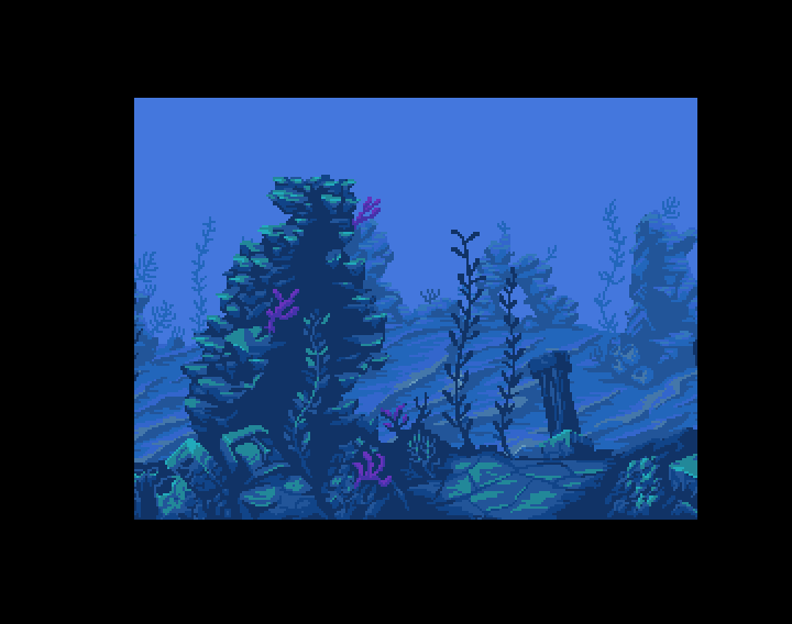

            Nouveau petit exemple d’un scrolling dual playfield : https://github.com/alain-treesong/amiga_coding_in_amos/tree/main/snippet-003_simpleDualPlayfield
            Les graphismes sont de Ansimuz  : https://ansimuz.itch.io/
            Il est très simple de faire un dual playfield, technique très utilisée dans les jeux (Chuck Rock, Shadow of the beast…).
            Dans le prochain exemple, je repartirai de ce code et ajouterai un troisième plan animé.

                                je viens de coder l’étoile…on est bien d’accord que la déclaration des variables est inutile ? (en global en plus alors qu’il n’y a pas de procédure utilisée).
                                La variable T ne sert pas.
                                Il y a double déclaration de la palette et du centre de l’écran :)
                                Le cls 0 est suffisant, pas besoin du paper, ink, pen.
                                C’est là qu’on voit les limites de l’éditeur, un IDE actuel mettrait des warnings là-dessus. (Ça le fait d’ailleurs dans AOZ ?)
                                Si je note tout ça, c’est de façon pédagogique, ça me permet de comprendre ce qui est utile ou pas, ça aide à comprendre ce que font les commandes, ce n’est absolument pas pour critiquer le code, ça me fait au contraire des petits TP :)

                                  C’est bien d’utiliser le code et de le critiquer d’ailleurs.
                                  L’ensemble du code proposé est fait à titre d’exemples et n’a pas la prétention d’être parfait, juste très bon ;-)
                                  L’étoile est extraite d’une démo, c’est pourquoi tout n’est pas utile comme la déclaration de T qui servait à mesure les FPS, code que j’ai enlevé pour réduire la taille de l’exemple. C’est similaire pour tes autres remarques.
                                  Puisque tu parles détection d’erreur à la sonar et bonne pratique, c’est mieux de déclarer les variables et encore mieux de les mettre en global quand c’est possible pour des raisons de perf et de réutilisation (éco mémoire). Le code de tracé de l’étoile est dans une procédure dans la démo.
                                  Enfin je t’invite à utiliser Amos pro comunity (que tu pourras étendre avec d’autres extensions) car le dual playfield horizontal déconne avec ta version (que je suppose non patchée) dans certains cas (position horizontal de l’écran non multiple de 16 il me semble).
                                  Cool que quelqu’un teste ces trucs !
