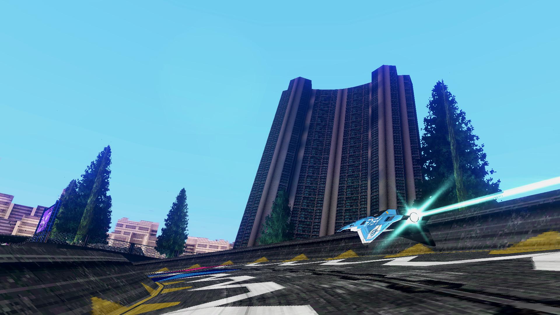

        BallisticNG (WIN 2018 Neognosis)
        https://store.steampowered.com/app/473770/BallisticNG/
